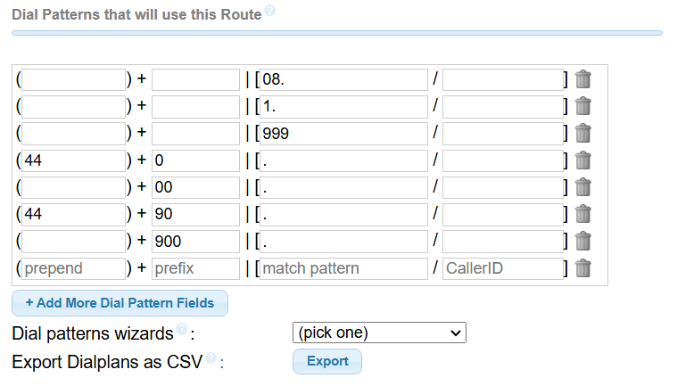

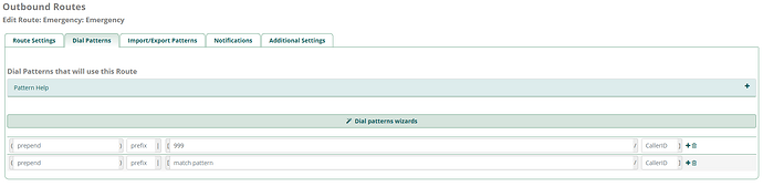

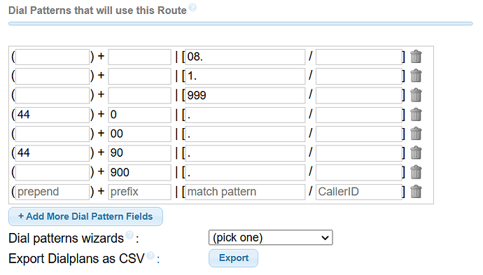

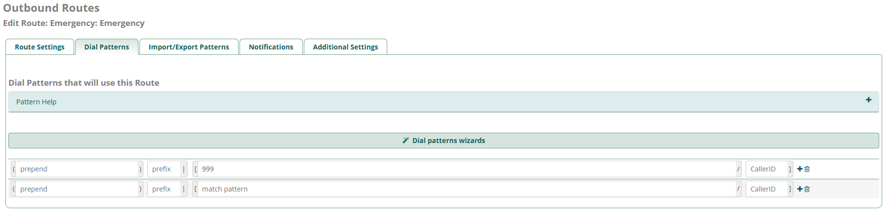

If you can you post the diall patterns you have on your outbound routes for both PBX’s that would be helpful to anyone trying to help.
The first image is the main PBX that has no issues calling 999. The second image is the PBX that cannot make calls to 999.
Thank you
You’ll need to isolate the full log lines for the call on each system. Start with the first, and see if the call it attempted to thru the peer trunk. If it is, then do the same on the second system and see at which point the call fails.
