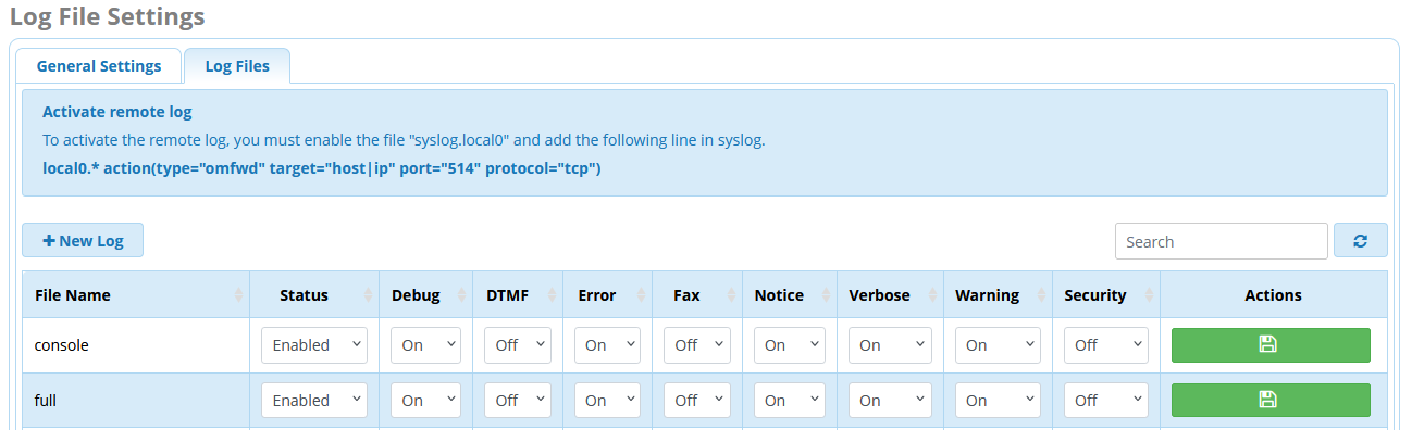

In fpbx, if you browse to settings, Asterisk Logfile Settings, you can select what types of events get logged. This is what the defaults look like on a new TangoPBX
The defaults have most of what most people need, but I would point out two items here that are disabled by default that might be useful for some. The first is DTMF. By default DTMF is not logged or displayed on the console, and if you’re trying to debug IVR navigation or similar, that might be useful. The second is Fax. If you’re one of the unfortunate many that must endure this scourge on your systems, enabling fax logging might go a short way toward mitigating your misery. Set either or both to on for the console and for the log, then click the green buttons on the right to save your settings.

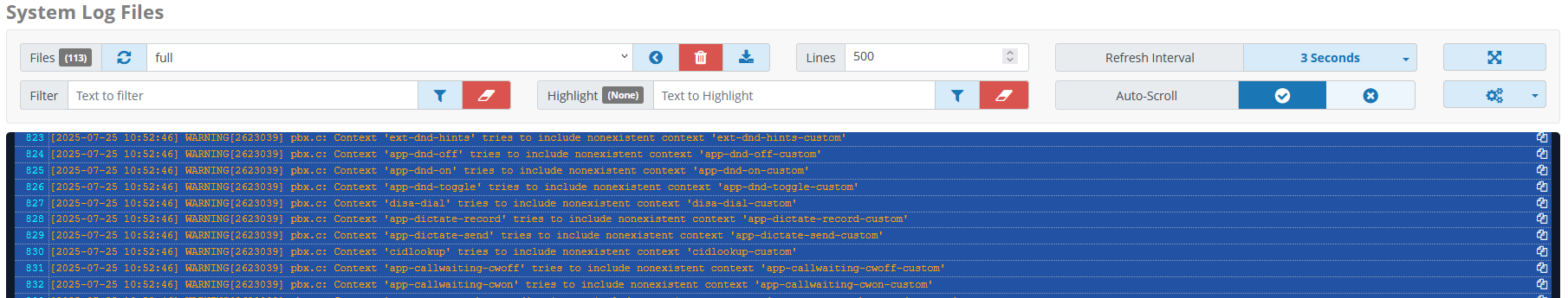

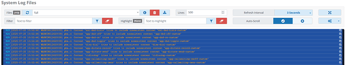

I’m old school when it comes to looking thru logs. I’m mostly comfortable using the Linux prompt and greps to locate what I’m looking for, but it’s not for everyone. Particularly those who don’t do this type of thing daily. So lets delve into the System log files module. Browse to Reports → System Logfiles and this is what you’ll see

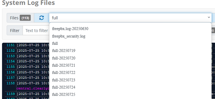

A few years ago, this module got a major overhaul. Using the dropdown menu in the upper left, you can select one of any of the logs on the system and thanks to The Basics above we know why there are several full logs available with dates appended
There’s also a search filter also on the upper left, and various controls for freezing the display, increasing the number of lines displayed, etc.

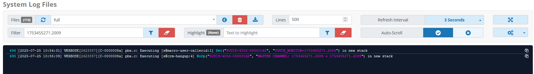

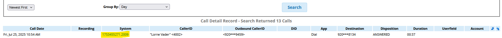

As stated above, we want to isolate the log lines for one specific call, the call trace. I do that by starting in the CDR. I locate the call in question using the search tools in the CDR then I find the UniqueID of the call, this field in the system column:

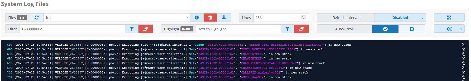

I copy that string and then browse over to the System Logfiles module and paste the UniqueID for the call into the search filter. Provided I’m searching in the correct log file (select one of the previous days if necessary) I should see only a couple of lines displayed:

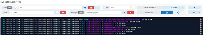

What I want now, is to copy the string in the third set of square brackets, and search for that string in the same log file. In this example the search string becomes C-0000008a:
What remains in the screen below is all the log lines for the specific call you’re looking for. You can now copy that content to do whatever you want with. If you’re asking for assistance, you can paste it in a text file and attach it to a ticket. If you’re looking for help here in the forum, you can copy/paste it to a text sharing service such as pastebin or between code tags in a forum post with your question.
