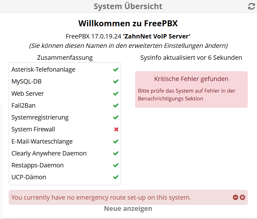

You currently have no emergency route set-up on this system
Hi,

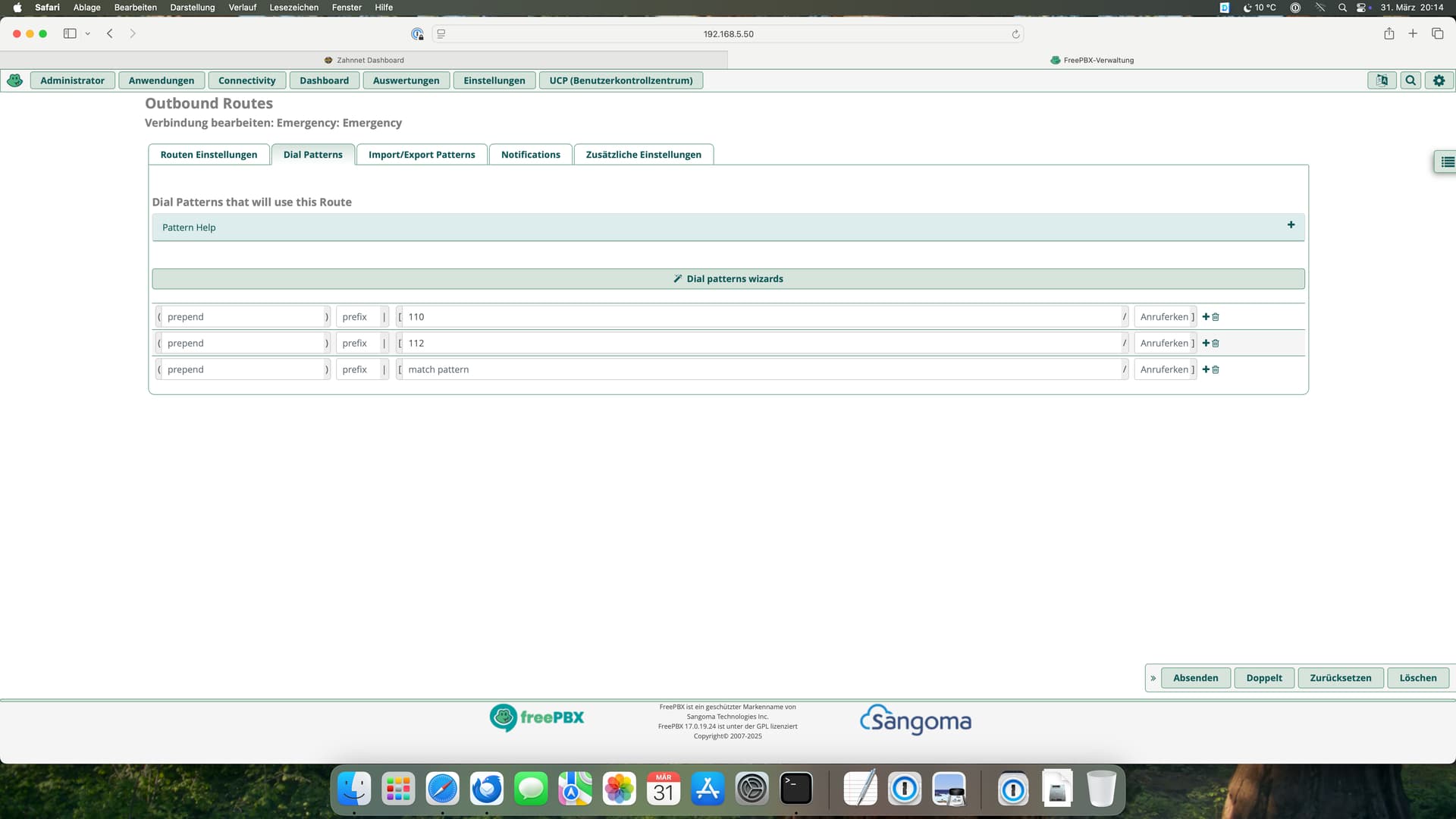

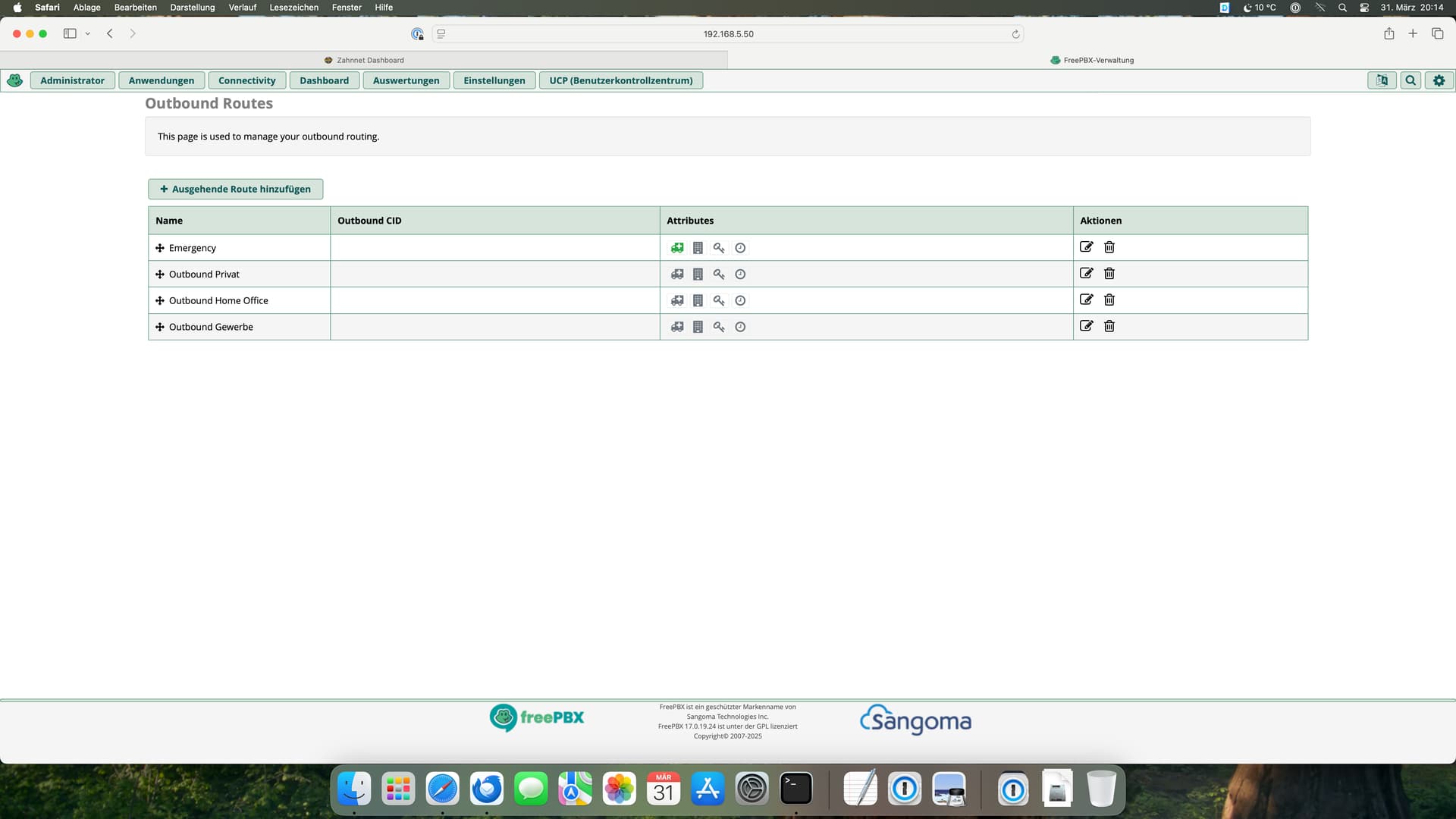

another little issue. Since the ClearlyIP Support Guy was on my system to fix an error, I have this error on my Dashboard. But there IS an Emergency route.
Found out, that it maybe is an error from the Clearly Trunking Module which was installed. But since I cannot use it I have removed this module but the error still exists.
Greeting

I assume you are seeing this error on the dashboard.
Silly question but after removing the Clearly Trunking module did you simply delete the error message on the dashboard? If so it shouldn’t come back with the module uninstalled.
Hi
Yes the Message appears on the Dashboard. And I can also click it away and the Box Turns from Red to green but with every new Message this Message ist coming Back.

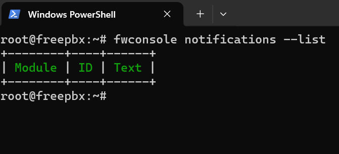

Well no notifications:
But in the GUI the message is still there:
