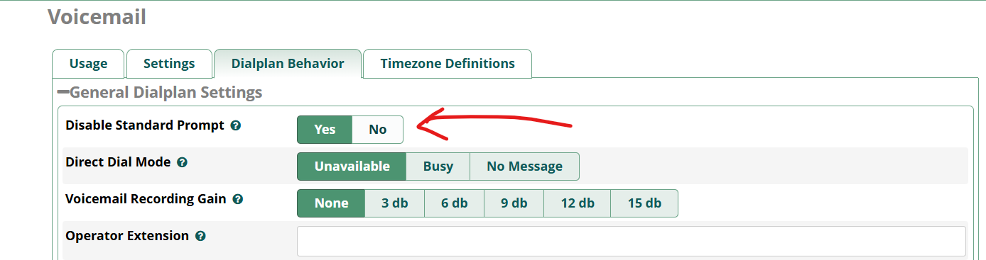

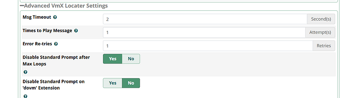

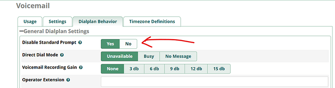

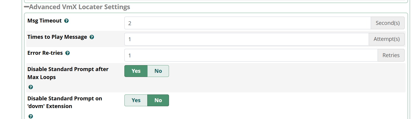

I tried turning off the voicemail instructions so that only the greeting is heard but no matter what I try the instructions still play. Is there perhaps somewhere else to adjust this setting outside of the extensions voicemail VmX or the Settings > Voicemail Admin?
You could look for the audio file and change it to a second or two of silence. Look here /var/lib/asterisk/sounds/ for these files “vm-instructions,” “vm-login,” and “vm-maininstructions”
@kenn10 that’s the point of this post, I did that and the system was not respecting the setting. I’ve done it since and it seems to have worked on other systems, perhaps there was a bug that got fixed??
I also have these settings. I am not using Tango, just IncrediblePBX-2025 with current FreePBX-17 modules so I can’t explain further. It works on my system. FYI, I’m migrating several systems to FusionPBX and the voice mail is much simpler with fewer options than FreePBX. It simply plays the recorded greeting and beeps.
