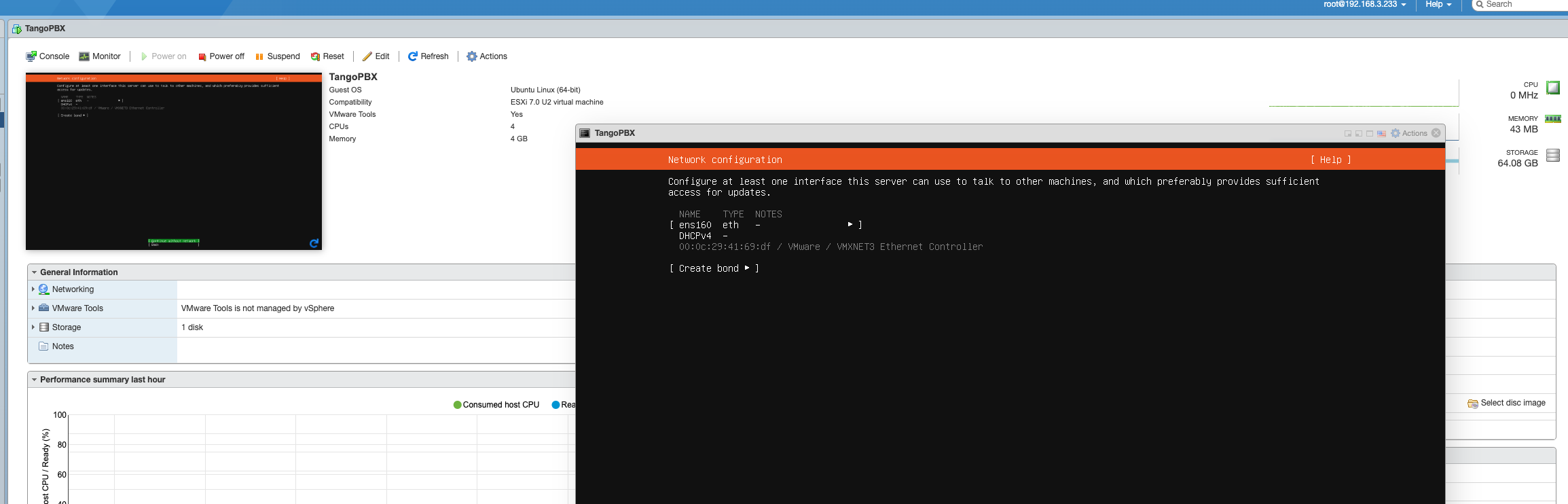

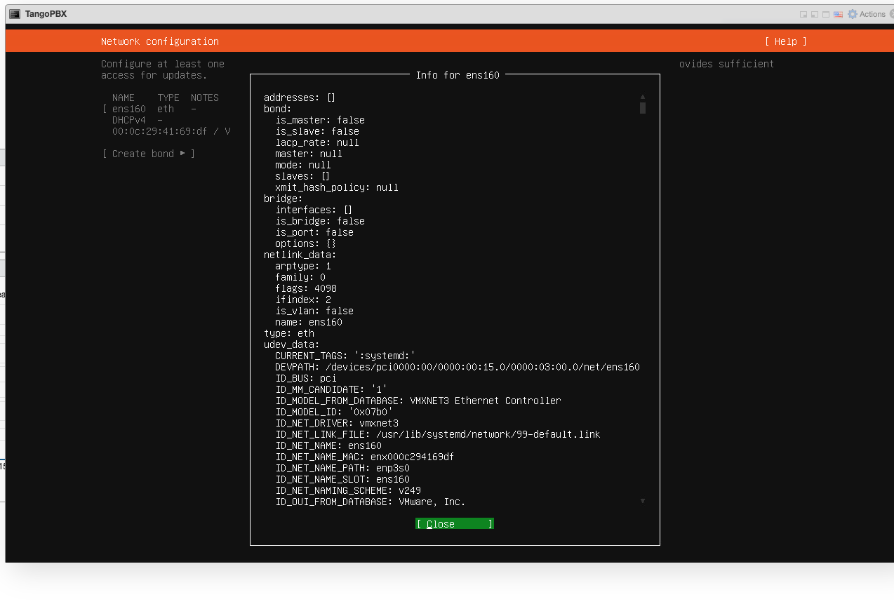

TangoPBX ISO is not picking up DHCP ip address.
ESXi 6. Im sure DHCP works on it. Also will test it in a FreeBSD bhyve soon
So far, we have seen that you have to select the adapter and then manually select DHCP. Then it will pull an IP address from the DHCP server. For some reason, the installation routine is failing to draw an IP address on the first attempt. This has been noted on a Vultr VM and VirtualBox.
