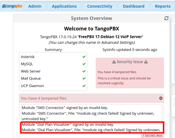

The TangoPBX module threw up red alerts on the dash. Signature related

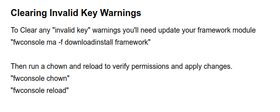

Yes after you install the branding you need to do a module update on framework so it has our signature for our signed modules.
Maybe add that to the Wiki article?

Fixed the invalid Key for the TangoPBX Branding. For those who need it:
Quick one @tonyclewis, how does one get a module signed? There is the dialplan visualizer, that would be a nice addition to TangoPBX
I added this to @lgaetz wiki post about the module.
The module has been signed by sangoma so it will be valid still, no seperate signature needed.
We don’t remove any of their keys only append ours. Let me see what needs to be done to review this.
