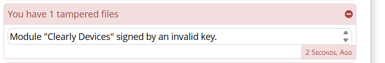

I have this message on my freepbx dashboard.
Is there something to do about it or I can leave it ?
Hi Giti!
Are you using TangoPBX or is this on fpbx? As far as I know, there are no published versions of the Clearly Devices module that don’t have a valid signature, so if you’re on fpbx, it’s probable that you need to update the framework module from the Clearly repos.
Hi Lorne,
Its fpbx. Will updating framework from Clearly repos have any impact on the pbx? This pbx is in production.
No, there is no impact.
