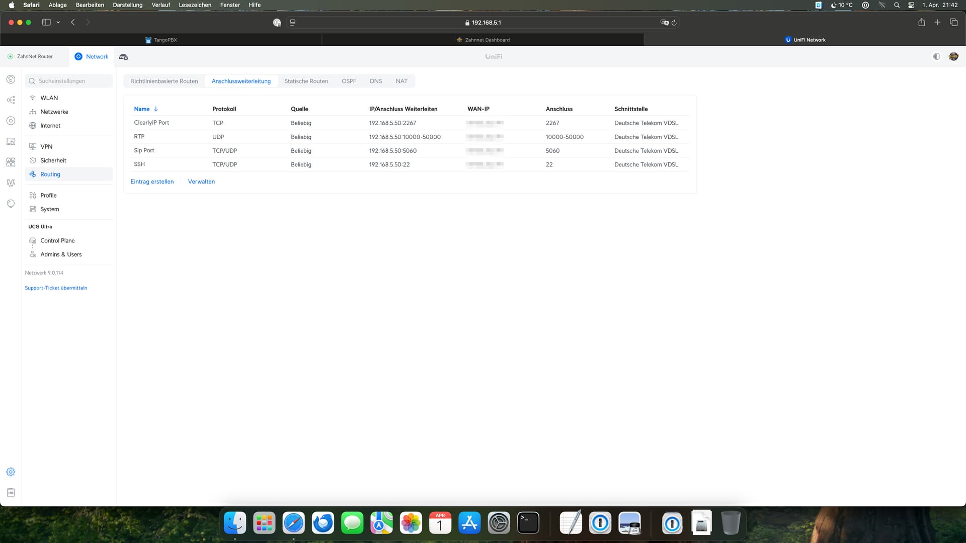

Seems I now have suddenly a Problem with communication between my FreePBX and my Mobile Devices. When my Mobile Phone is in the same LAN as my FreePBX everything is fine. When my Mobile phone is connected to the mobile network only I can dial and ring the extension but when I pick up I can’t talk or hear anything. I know this is an RTP Issue but RTP Ports are allowed in my Routers Firewall. Outgoid rules are all allowed. The FreePBX Firewall ist turned off.
My Router is a Unifi Gateway Ultra and my DDNS Provider is No-IP.com

Setting>Asterisk SIP Setting do your RTP Ports match what you have in your Unifi’s Firewall Rules? Standard is 10000-20000.
