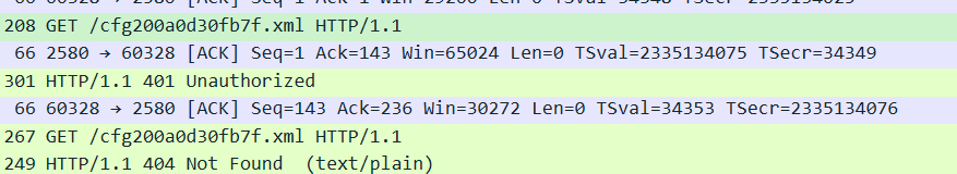

Phone tries to get the cfg file :
I can see the cfg file

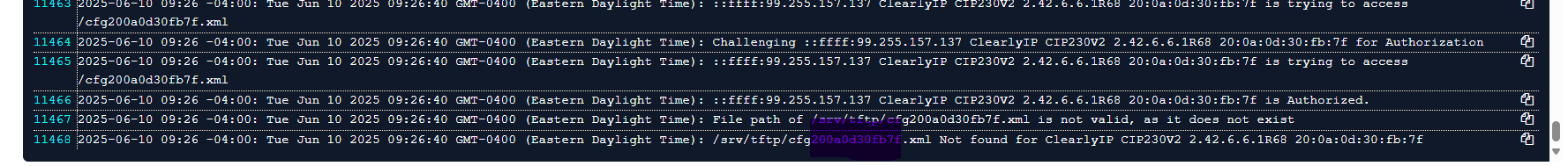

This is the message I have there:
Mon Jun 09 2025 22:08:59 GMT-0400 (Eastern Daylight Time): File path of /srv/tftp/cfgxxxxxxxx.xml is not valid, as it does not exist
But files are under /tftpboot Can I change this path to check /tftpboot?

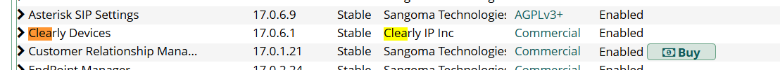

There was an issue with Clearly devices 17.0.6, which was updated to 17.0.6.1, where the http server was not pulling from /tftpboot but /srv/ftfp
Check System > System log files > clearly devices log
Same error message and
I have 17.0.6.1
