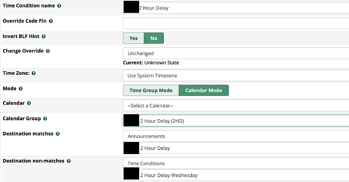

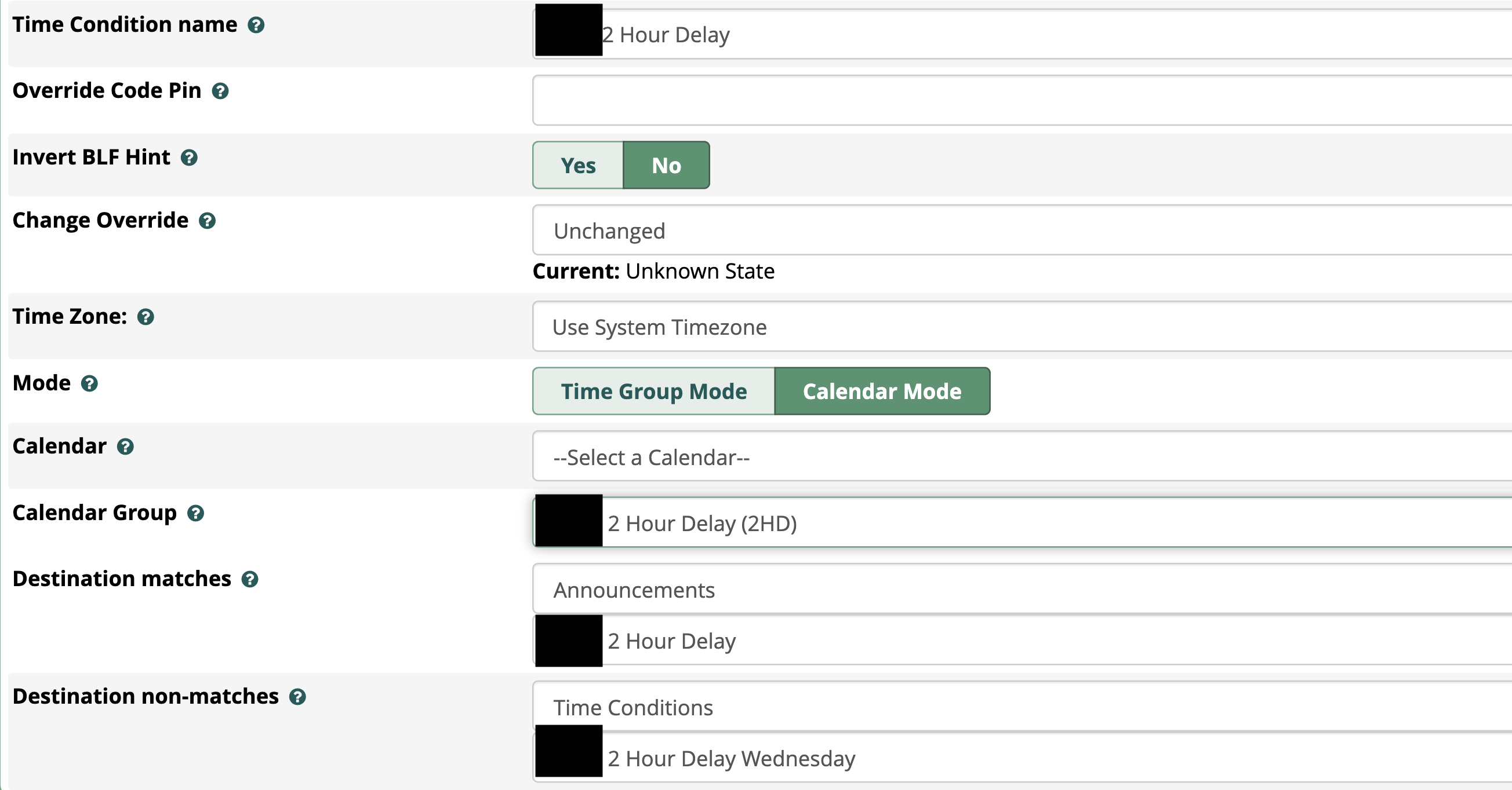

I am fairly certain, Open Page does EVERYTHING, Page Pro does. Make sure your local calendar has specified event group for all possible “Events Groups”(holiday,snow day,2hr delay, etc) that may be used, from there you go to time conditions and see the following example:
I highly recommend you get the dial plan visualizer tool @madgen has shared and continues to work on and build a test 5555555 route to build this all out. I used event like HOL=Holiday, 2HD=2 hour delay, AH= After Hours, You can keep it as simple or as complex as you want, but I will say if its incredibly complex and depending on the size of your system make sure you have a good amount of RAM or Asterisk will have an issue.
I hope this helps you out.
-Taylor
