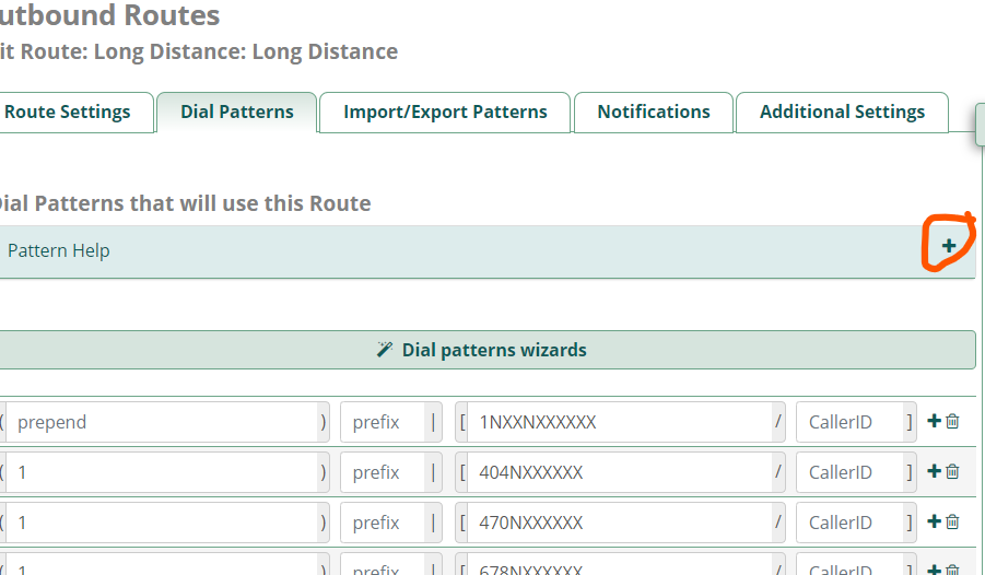

Can I Set more then one Extension to Match ?
Yes you can. On the outbound route Dial Patterns screen hit the + in the upper right for explanations. In your example you could set caller-id to 2X for one route and 3X for another to route extensions beginning with 2 on route A and extensions beginning with 3 to route B.
Thank you. Seems to work……
