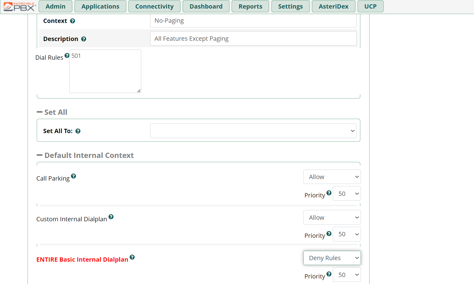

Custom Contexts module works with FreePBX-17 and that module is free. It allows you to create different contexts for extensions and allows you to restrict features in each context.
After you install the module, you can create new contexts and then select them from the Extensions > Advanced tab.
So if let’s say I had extension 501 as a page group extension and I wanted to restrict that so only 301 and 302 can call it. Will I be creating a custom context for 501 or a custom context for 301 and 302? I think doing it for 501 would make the most sense as that’s the only one I want to restrict
Paging is not something you can restrict in a custom context but the number dialed can be. You’d create a new context, like “No-Page” and use Deny Rules. You need to click on each of the question marks in front of the fields for explanations. In theory, you’d change to context to the No-Page context to prevent them dialing 501 for the page.

Neither. You will be creating a custom context that denies the use of 501. That would mean you would need to update any extension that isn’t 301 or 302 to use this new custom context.
