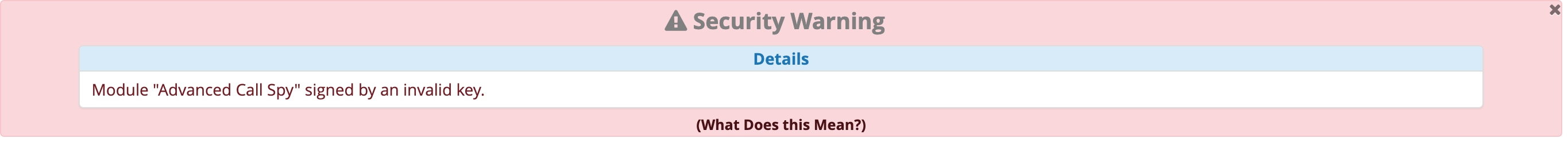

Well on both my FreePBX v17 that I switched to the ClearlyIP repos to install Framework and Openpage and my pure TangoPBX distro install…I get this:
Running refreshsignatures gets this:
Checking Signatures of Modules...
Checking advcallspy...
Signature Invalid
Could not find signed module on remote server!

Yeah, that was the step I was missing. I put it up and now when I do a refreshsignatures it shows good. It shows that it is valid signature in Module Admin. Still getting the big old red banner on my dashboard for both my module and Bill’s SMS connector but the same thing. Module Admin shows everything valid, the module signatures look fine through fwconsole just that the dashboard throws the warning error even have a restart and reboot.
