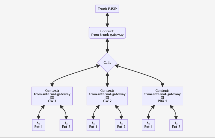

I created a module Gateway to connect any Gateways or Trunks on a PJSIP extension.
Your FreePBX or PBXact is a kind of SIP router.

What does this module do? Because based on this diagram it looks like three FreePBX systems connected to a single FreePBX system. So what does this gateway module actually provide for this?
Is this like a multi-tenant solution? So for instance one PBX can handle multiple tenants in a office building??
Making FreePBX multi-tenant would require a complete overhaul of how the system works.
that was my understanding so I guess I’m still confused as to what this module is supposed to do exactly. What problem is it solving?
It’s letting you have a FreePBX box act as a mini soft switch and hang other FreePBX systems off it and use the extensions as the DIDs from what I can gather.

Imagine a FreePBX (primary) system to which many other FreePBXs, IPBXs, or gateways (SIP/ISDN) are connected.
The primary FreePBX system routes calls (primary DID and DID) to FreePBX client or gateways.
FreePBX is a kind of SIP provider.

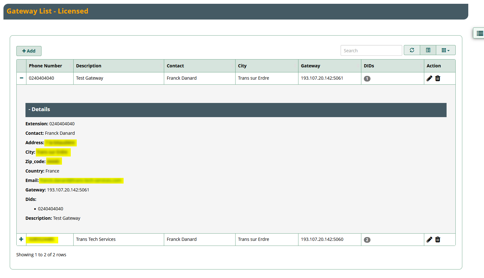

A customer is defined as an extension (e.g., 0240404040) and can have multiple DIDs on the same extension.
On the FreePBX client side, you need to set up atrunk to the FreePBX main just as you would for any SIP provider.
We used this type of configuration for our clients in France. We installed FreePBX servers at their premises and provided them with a trunk connected to the main FreePBX server. This main server was connected to three SIP providers: a primary trunk and two backup trunks.

Yes, maybe you can do it manually on FreePBX. I just created a module to do that through the GUI. It’s a FreePBX module.
