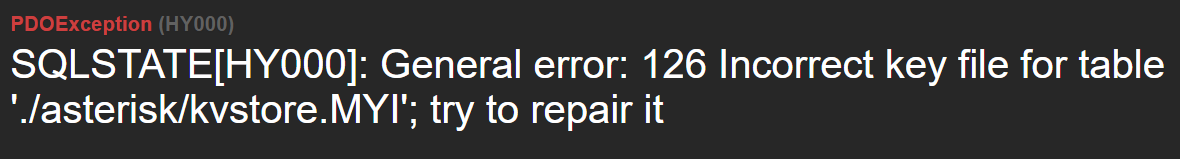

KVStore table error--How bad is it?
I have an old system Version 13 I think and I am getting this error
This system is the hub of a multi-location school district. ALL outside calls go through this machine. So I need a solution to this error that won’t shut the system down at all if possible. We are in the process of consolidating all the systems into a single machine. I need to get a crapton of info from that system If the fix for the KVStore is iffy, can I get info similar to Bulk handler, especially extensions.
Thanks for any suggestions!
