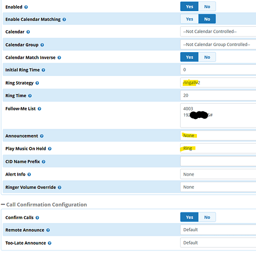

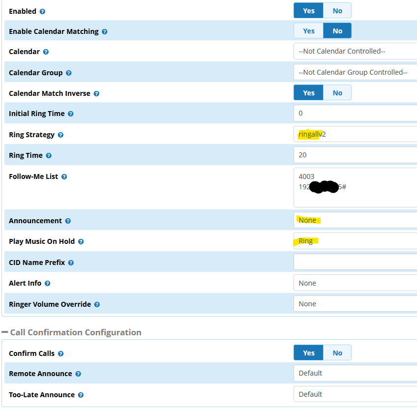

Looking at the call trace shortly, but I can confirm that using FMFM to an external number is working okay for me, both with confirm calls enabled and disabled. These are the FMFM settings that are working for me.
My FM/FM is the same. I don’t know where the 2000 ms timeout on the call to the cell phone is coming from.
Remember I’m on IncrediblePBX, not Tango.
The 200ms is the timeout for dialing 211, do you have FMFM setup to ring the primary extension for 2s before going to the FMFM group?
