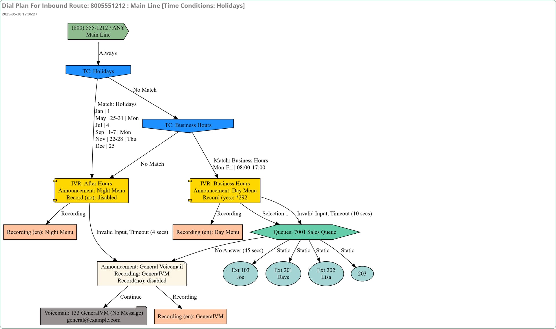

The latest release brings a number of improvements. Here’s a quick and basic example to get you started:

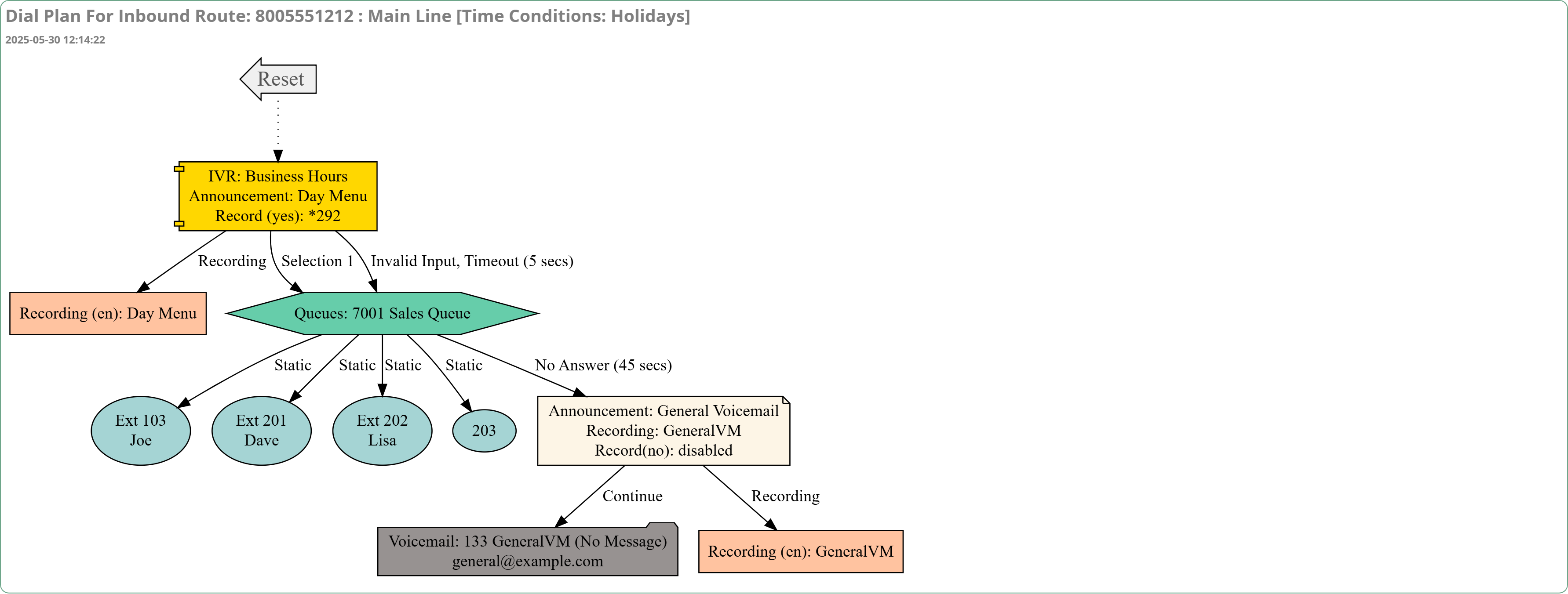

Ctrl + Click on a node to redraw starting from that point.

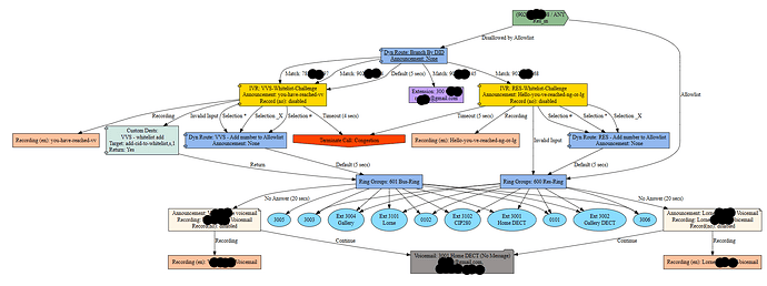

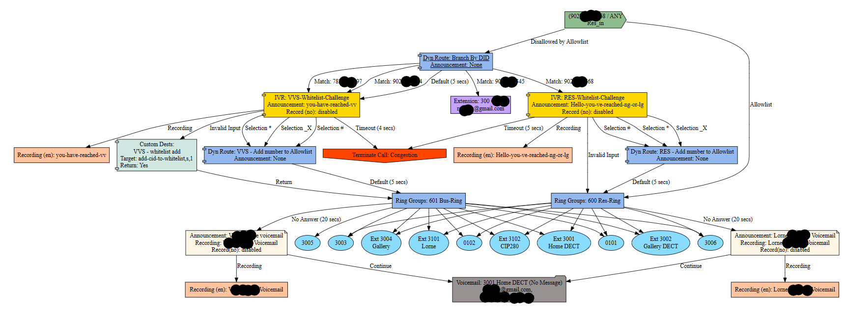

This spiderweb represents what happens when someone calls my main prod system. If the caller’s number is on the allowlist, they go directly to a ring group. If not, there’s an extra step involving the caller successfully navigating an IVR. If they get past my IVR, their CID number is added to the allow list and then directed to the ring group.
That looks good. Did the module work as expected? Or, did it miss a step?
It all looks correct. Two thoughts though:
  1. There is no visual element for the blacklist. Another arrow from the inbound route labeled blacklist showing the blacklist destination might be helpful for some.

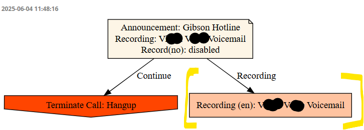

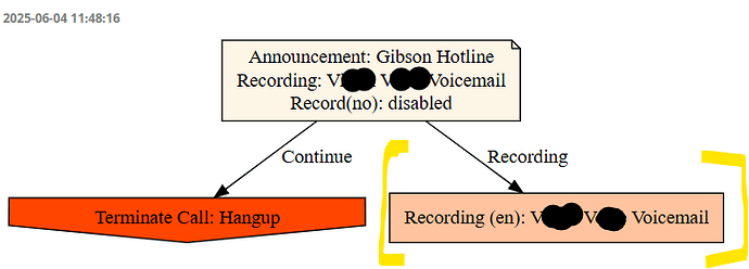

  2. What value does the peach colour recording box add to the chart when drawing announcements? The announcement box already shows the system recording name, and the arrow suggests that the call might flow in that direction when it won’t.
Blacklist may be a good idea.
Clicking this node will show a modal with the audio element without going to System Recordings.
You’re right, maybe the arrow is misleading. Maybe reverse the direction?
Clicking on the Announcement node will take you to the edit page.
Ah, I see that now, and it would be particularly useful for compound recordings. I think reversing the arrow or removing the arrow and just leaving the line might make it more logical. I see that same in IVR and other places where there are recordings defined.
Yes. Compound recordings are also supported and will appear as multiple audio elements. Also…if language is changed in previous nodes, recording nodes will show the language and play the correct audio files.
New version will have the feature code on the recording node instead of announcements or ivrs.

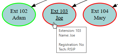

  • Registration status for PJSIP, SIP, and IAX2 tech for extension, queue agents, and ring group members.
    • Registered: green | Unregistered: red
    • Tooltip shows the tech.

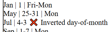

  • Check for inverted Time Groups (month, day of month, time)
