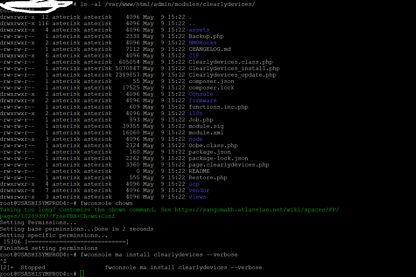

Is this correct command to run from CLI
~# fwconsole ma install clearlydevices --verbose
Nothing is happening in cli either
If you have Clearly repos enabled, or if installing on TangoPBX then the command is
fwconsole ma downloadinstall clearlydevices

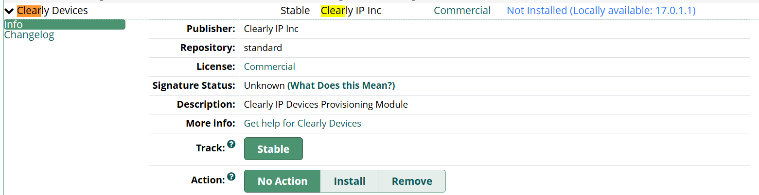

This is what I have under modules now. Neither installing from web nor CLI works. It just stays there for ever and I have to stop process.
That version is old and problematic, get rid of it with:
fwconsole ma delete clearlydevices
then download the current version with
fwconsole ma downloadinstall https://mirror.clearlyip.com/modules/clearlydevices/clearlydevices-17.0.5.tgz

All the URLs work. If you can’t get to them from your PBX then you can always manually dload the tarball, and decompress it into the appropriate folder on the system
/var/www/html/admin/modules/openpage
Then chown to asterisk:asterisk or run fwconsole chown
I was able to download it from my browser and upload it from harddisk and that’s what I have
This is the version 17th.
And I have it installed on version 15. I will play with this one for now. Thanks. Appreciate your help!
