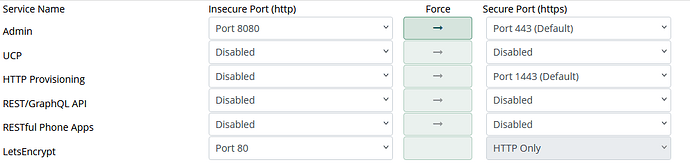

Simply trying to set the ports as the following to allow lets encrypt to create a cert
Changing Admin http to anything other than 80 will break Clearly Anywhere on FreePBX17
It doesnt address your concern, but you can generate an LE cert with any service is bound to 80. The LE option for 80 is only there if no other service is using 80.
