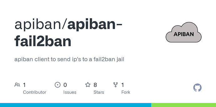

The fail2ban client lives on GitHub. If you’re the type that likes to peek under the covers, you can see the code and docs here:

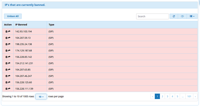

I’m testing using a low spec VM from vultr, so it took several minutes for the install to complete. While waiting, you can monitor the progress of the initial sync in the GUI by browsing to the Intrusion Detection tab in the Firewall module. You will see the Ban list slowly grow as the entries are synced.

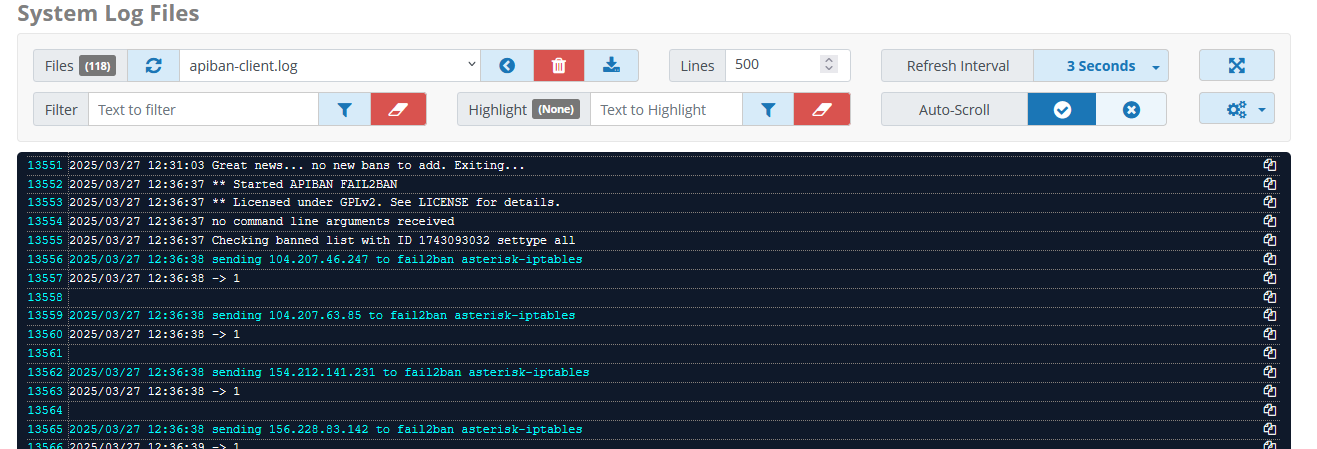

After a few minutes you’ll see the client install finish. A periodic check of the ban list will show the numbers fluctuate from time to time so you know something is happening, but perhaps you’d like to know what. By default, the APIBAN client logs to the file /var/log/apiban-client.log. If you’re comfortable with the command line, you can grep away there. If you want to browse the logs using the GUI, there’s one more step. Run this command:
ln -s /var/log/apiban-client.log /var/log/asterisk/apiban-client.log
This will create a symlink to the APIBAN log in /var/log/asterisk/. Now you can use Reports → System Logfiles to see the logged APIBAN events by selecting apiban-client.log from the dropdown menu:

The default installation will add both the known SIP and HTTP “attackers” to the jail.
Ah yes, I forgot to mention that. The IP list is has both SIP and http abusers, but they will all appear in the the GUI as SIP abusers, as that’s the fail2ban jail that’s configured.
