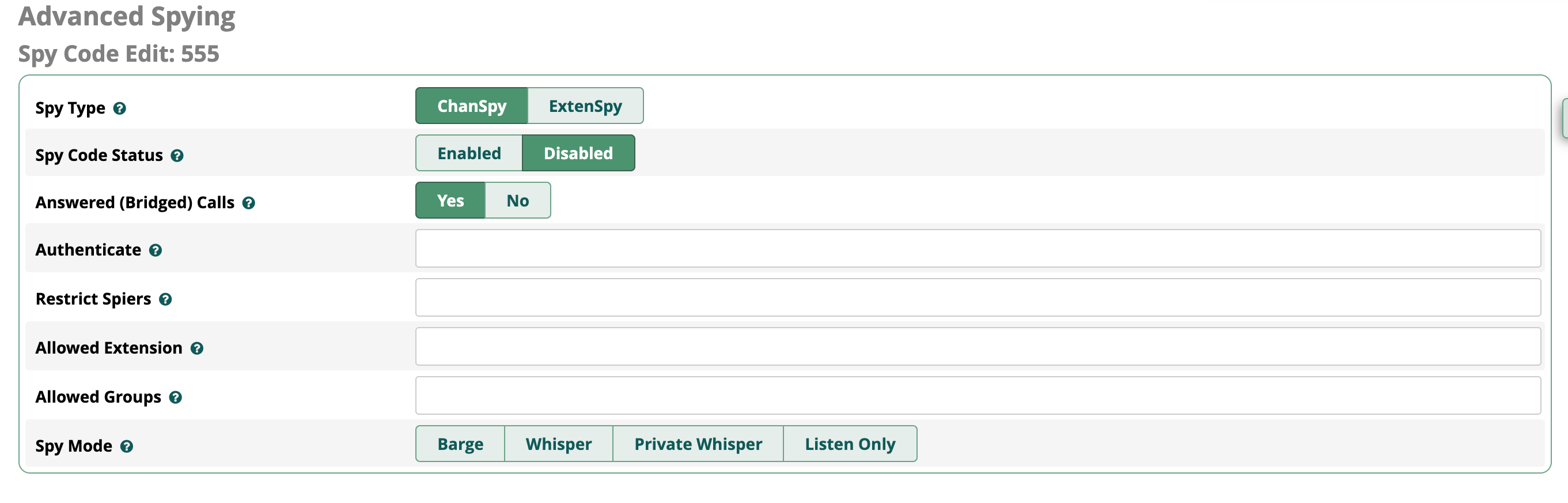

  • It will disable the 555 ChanSpy feature code used by default in FreePBX and replace it.
  • Multiple Spy Codes (feature codes). This will allow for more than one feature code to initiate spying. Allowing for each Spy Code to have its own feature set.
  • Choose whether the Spy Code is ChanSpy (default) or ExtenSpy
  • It will allow for an authentication PIN to be set. This will require any user to provide the PIN in order to spy.
  • It will allow you to configure which options are available such as Barge, Whisper, Private Whisper, etc.
  • Extension Restrictions - restrict which extensions can be spied on.
  • Spier Restrictions - restrict which users can use the Spy Code.
  • Spy Groups - Create Spy Groups, add extensions to the Spy Group and restrict Spying to one or more groups. If the extension is not in one of the groups, it can’t be spied on.
  • Spy Recordings - Allow for the recording of channels/extensions being spied on. May not be in the initial release as I feel there should be an interface to view/listen to said recordings.

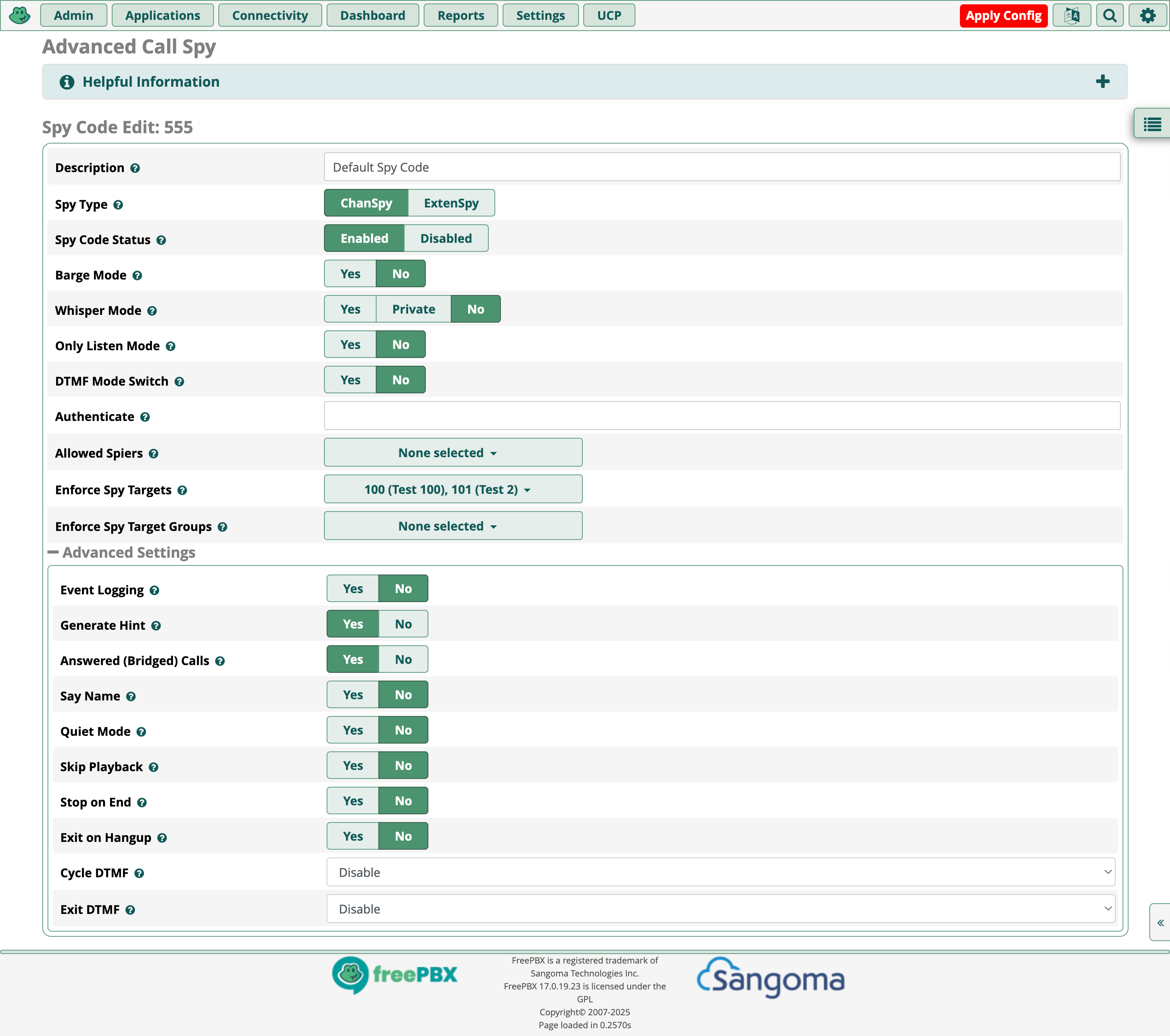

Notice the Event Log and Generate Hint options. You will be able log spy actions to the CEL. It will capture who the spier was, when they started spying, the spy code used. Can’t capture DTMF and different channels spied-on (that does get captured in the full log) but when the spier hangs up it will capture the end time and the last channel spied on.
As well, it you will be able to generate a BLF hint that you can monitor to see when a specific spy code has been activated.

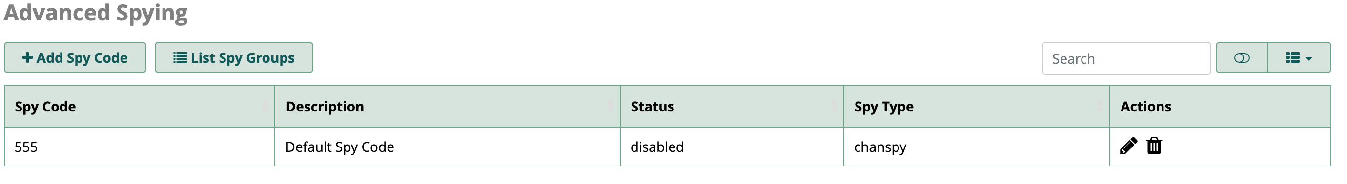

Spy Code

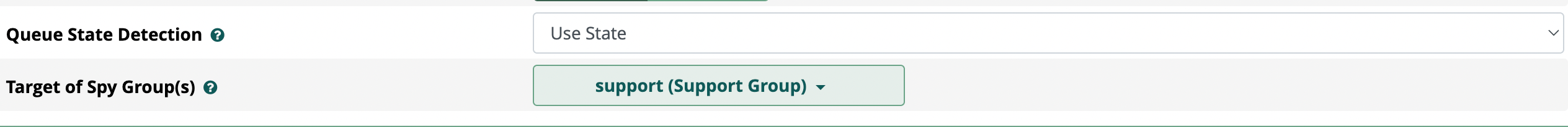

Spy Target Group
Hooking into the Advanced tab in Extensions

I’ve been doing some pretty basic testing of 17.0.1.2, points in no particular order.
  1. Once a spy code has been created, you can’t edit the group dial code. This is not a huge deal, and to resolve you would prob have to abandon using the feature code as the table index and instead refer to them by ID. There is value in having an internal ID for the spy codes that is fixed, so everything else is editable.
  2. When editing a spy code, the previously set authenticate field shows as blank. Not sure if this is a bug, or an intent to mask the password.
  3. Can you remove the authenticate PIN from a code once it has been set?
  4. I was assuming that this module would support spying on users directly dialing to them, i.e. 555101 to spy on 101. Is this something you have planned, or would appreciate PRs to support?
  5. Whats the difference between chanspy and extenspy for type?
  6. The hint generated is only useful if a single user is using the spy code. Once a second user dials the same code, then the hint status will just show the most recent change. I also note that state does not get set back to not_inuse if the spyer just hangs up instead of using the exit dtmf code.
  7. Stray thought, consider integrating with the Pinset module for authentication. No shared password that way, multiple users could have access to the same spy code with unique PINs. Simple update to the pinset can remove auth for one user without affecting others.
  8. Creating a new spy code, the page does not go back to the list after submit
  9. Authenticate field does not validate for non-numeric input
  10. I like the controls for suppressing the playback of channel type, i find that interminable on the stock feature code. (Pee Jay Ess Eye Pee)
  11. I can create a second spy code for 556, it shows in the GUI but does not generate the asterisk dialplan for 556

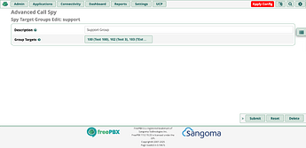

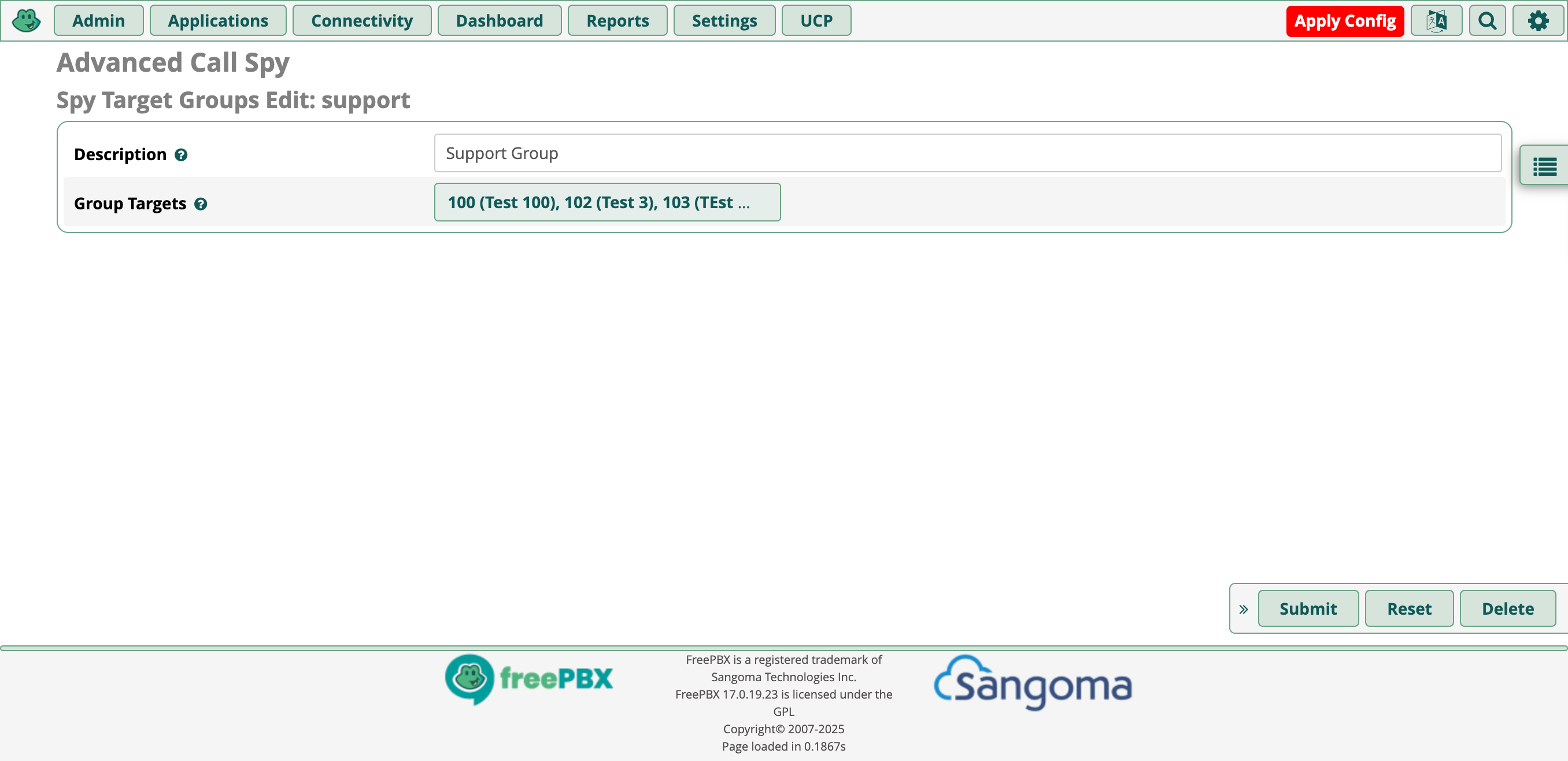

@lgaetz gave me some nice things to tweak. Sure he’ll enjoy this one:
SCR-20250617-j25
