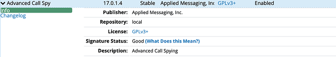

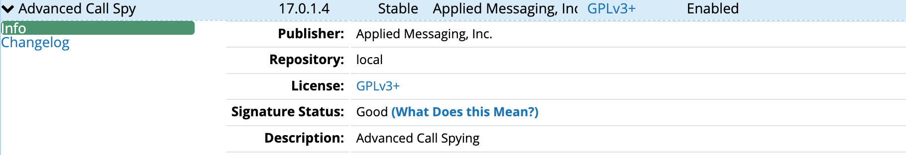

Module still shows as unsigned on Tango, did you figure out how to resolve that key issue?
Are you referring to the big red alert that appears on the dashboard? It also tells me @billsimon’s module is unsigned as well. However, if you run fwconsole ma refreshsignatures it shows that the signature is Good. If you look at it through Module Admin it says the signature is good.
My previous problem was I didn’t make the key public, which I have done per @theJames help. Before I made it public, the signature showed as “couldn’t find on remote server” when doing a signature refresh and module admin listed it as unsigned. Those two problems are gone.
It’s been throwing that error on the dashboard since I installed the SMS Connector module while every place else says the SMS Connector module is good. I ignored that warning on the dashboard at first because of that for this module. It wasn’t until I saw the other places throwing errors that I figured I missed a step with my key.
Still haven’t figured out how to make that warning go away…even when I uninstall advcallspy during testing…that warning still shows for the SMS Connector on the dashboard.
