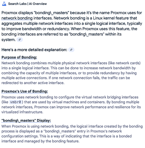

Might be trying to do too many things in the Network Config option. If it’s a bridged network (bonding_masters is a big hint), then you’re not going to be able to change the network settings without crashing things including the GUI. So display the correct info with ip a and call it a day. Gotta wonder if there is much of anything you could safely do to a network setup from within the GUI that wouldn’t require a reboot. Maybe Network Info would be a better use of the real estate.
This is only a big hint if ENI is how the network is being managed. Netplan, networkd and NetworkManager all use something different to define the bonded interfaces. You would need to determine the network management method and then determine if there’s bonded interfaces the proper way.

@NerdUno: Does the ‘Interface’ bonding_masters have an IP address assigned to it in your virtual machine?
I’ve set up a virtual machine under Proxmox with Ubuntu 22.04 and IPBX2027, and I couldn’t reproduce the error. I’m seeing three interfaces displayed (the ‘physical’ ens18, bond0, and bonding_masters). Only the bond0 interface has been assigned an IP address.
So I’m wondering if I really need to reproduce the error or if the actual bug is that the ‘Interface’ bonding_masters is displayed in the web interface. What is this interface used for? Is it only necessary for internal OS functions, or is it typically assigned an IP address?"
Sorry, but this discussion is now officially above my pay grade. As I noted above, I think it would be much safer in SystemAdmin to DISPLAY network settings rather than allowing users to MODIFY them. This is an invitation to disaster IMHO.
https://pve.proxmox.com/wiki/Network_Configuration
