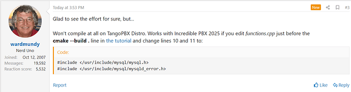

Well it looks like there isn’t a tar.gz file to install via Module Admin like normal. That would mean you would need to manually place it in /var/www/html/admin/modules/systemadmin
With Ward Mundy’s suggested mods, it compiles on IncrediblePBX-2025 and places the sysadmin directory and subtending files in the /var/www/html/admin/modules/ directory. However, the module does not appear in the FreePBX GUI (at least I could not find it.) I did a full fwconsole restart but don’t see any sign of the module in the GUI.
