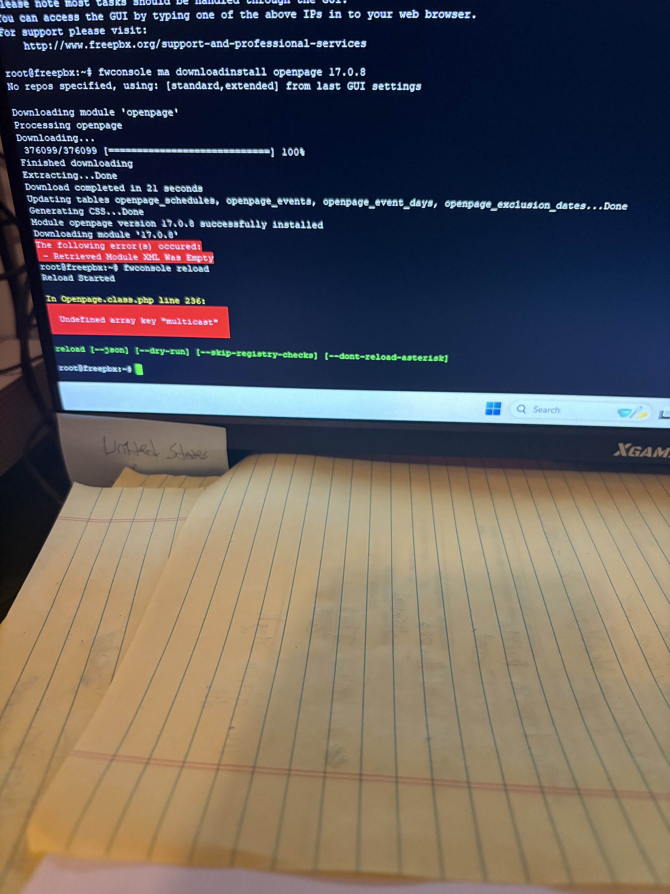

Sorry. Another bug here. Debian-12, FreePBX-17 on IncrdiblePBX-2025.
The module installs and works. However, when you make changes in FreePBX to anything and press the ā€œApply Configā€ button, everything appears to apply correctly.
If you drop into Linux and do the fwconsole reload, you get the error below:
 $ fwconsole reload --verbose
Reload Started
In Openpage.class.php line 236:
  [Whoops\Exception\ErrorException (2)]
  Undefined array key "multicast"

Bug ticket is opened here. If you find bugs please open tickets on our github project so we can get them fixed.

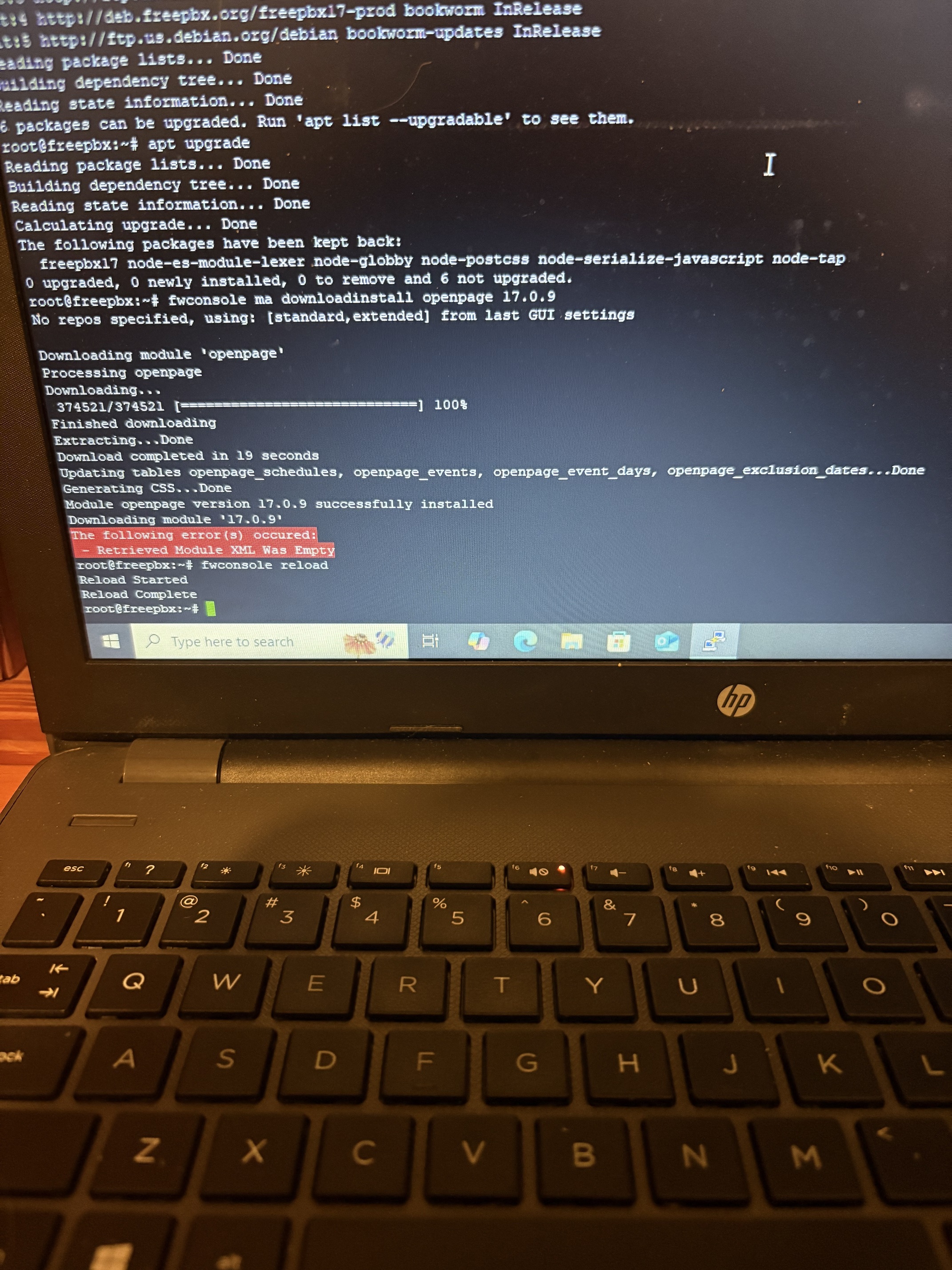

I have did the installation of 17.0.9 of OpenPage on my FreePBX, but I still have that error. Here is the error:

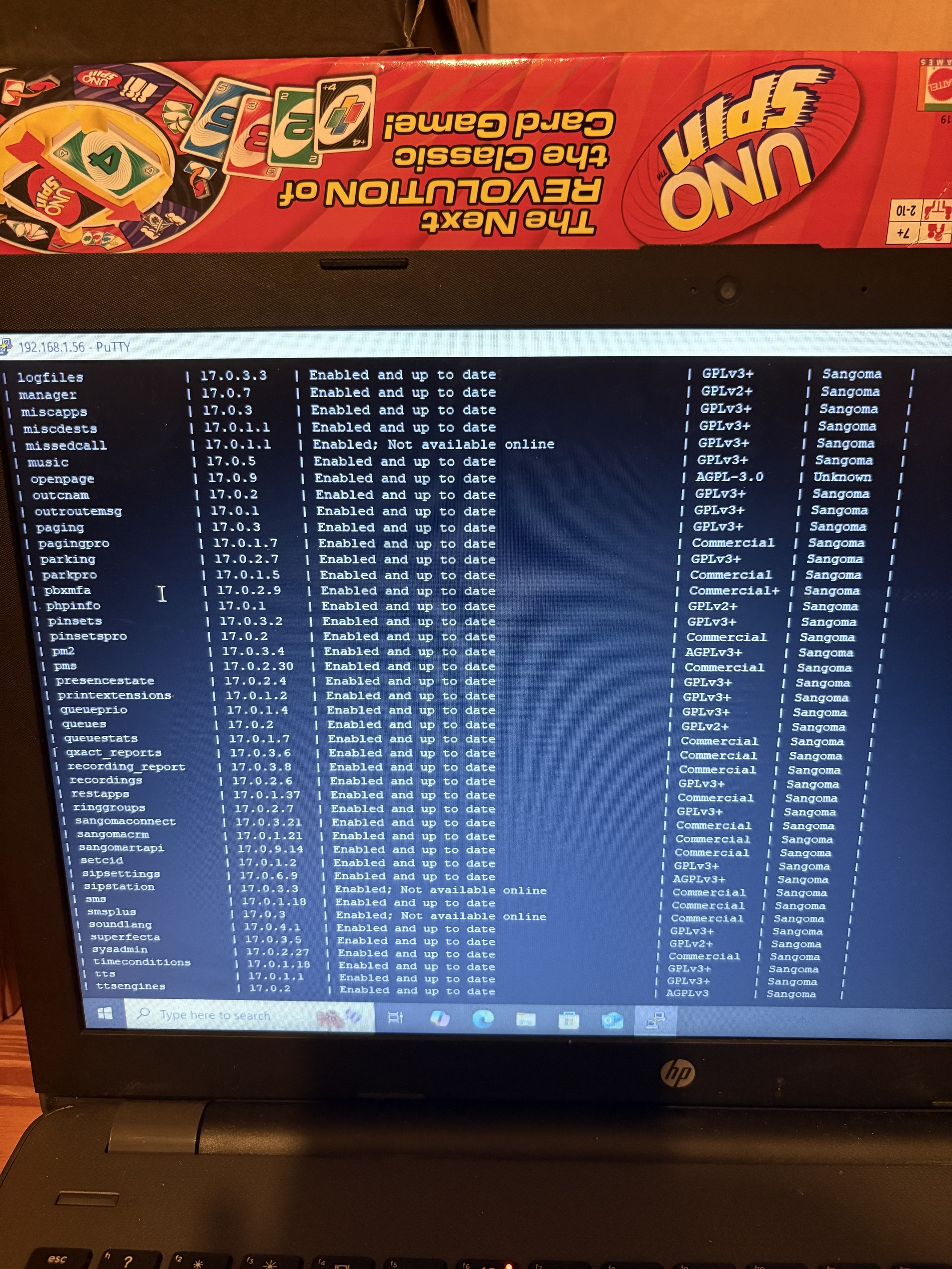

I looked on fwconsole ma listonline and open page shows it on there.
The error you display is from your misuse of the fwconsole command. It should be
fwconsole ma downloadinstall openpage --tag 17.0.9
The --tag is important, otherwise the command is trying to install a module named 17.0.9 which doesnt exist, hence empty xml.
I have done that and it worked. Thank you, and thank you guys for your time of figuring out.
